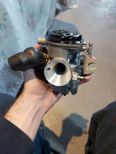

Ported&polished the carb&intake🤓

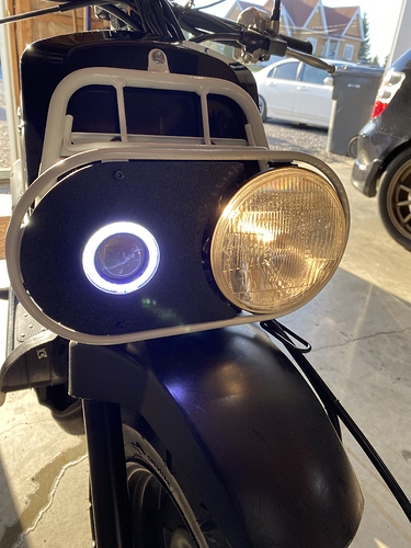

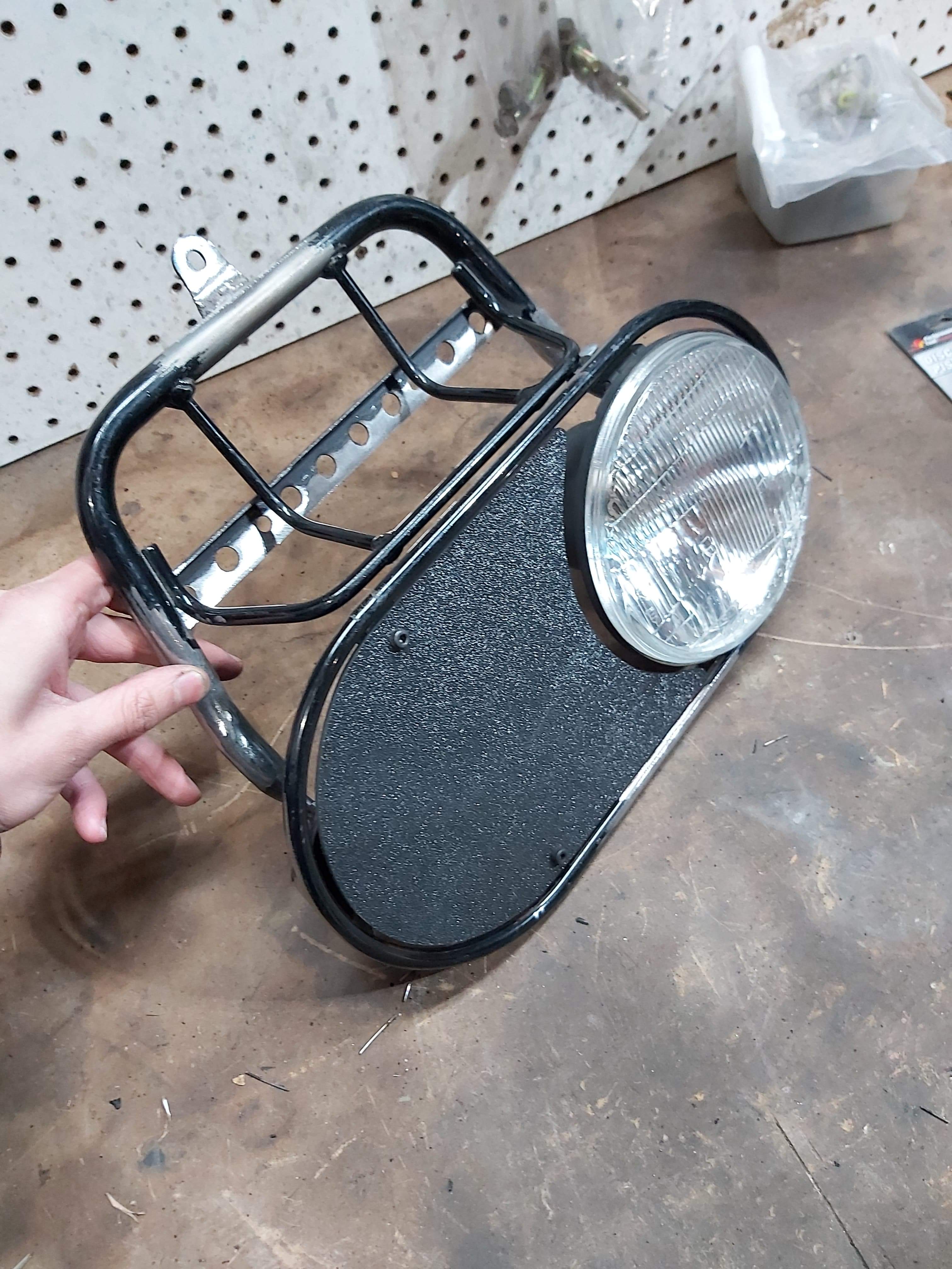

Custom headlight (one lens was cracked🥴)
Lowered headlight frame
NCY handlebar
